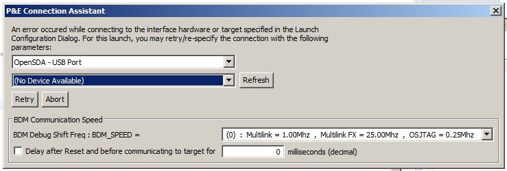

I then created a simple LED blinky program with PEx.  This builds and runs on my laptop.  It builds properly on my customer's computer however, when starting the debugger, it throws this error:
We downloaded the P&E drivers from their website today and installed them.  I am not sure if these problems are related.

I do have one hint, at least for the second problem.  The customer's computer has a previous installation of Atmel's tools, which also uses OpenSDA.  I'm wondering if we have some conflicting .dll files installed.

Hi Jim,
the P&E dialog indicates that there indeed could be a driver problem. I wrote back some time an article about the different aspects and parts of USB drivers needed:
Fixing the USB Drivers | MCU on Eclipse
Maybe this helps identifying the problem?
