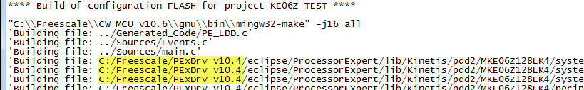

I have created a Processor Expert project in CW 10.6, for the FRDM-KE06Z board.  My only component so far is the processor, MKE06Z128VLK4.  When I build the project for FLASH, CW reports multiple definitions of __thumb_startup and __iar_program_start, first in startup.c and then again in __arm_start.c.  Since it's in the generated code, any changes I make to the code directly will be overwritten the next time the project is built, correct?  How do I prevent CW PE from generating erroneous startup code?

I think that console output shows the problem. For some reason the build system or the project wizard is calling files from Processor Expert Driver Suite (standalone version).

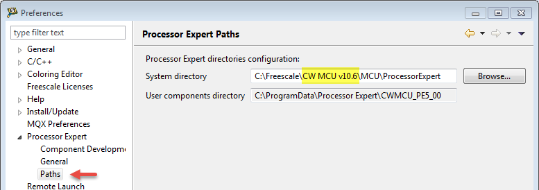

2) From CodeWarrior go to Window -> Preferences -> Processor Expert -> Paths and verify that the path is pointing to CW installation:

Your picture shows the "Problems" view. Could you post the console output in a text file or copied here?
This may give us a better idea of what is wrong.

Sure Jorge,  Attached is the entire contents of the console for the build.

NNeff
Thank you Jorge!!  That not only fixed the duplicate function definitions, it also is now producing a memory configuration file, which it wasn't before.

Option 2 worked.  I didn't know how to check on 1) so I just tried 2 first and it worked.  (I'm a newbie with CW for MCUs, obviously.  I appreciate the help.)
