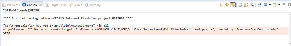

I have now run into quite a problem. I dont seem to be able to debug on the code for the coldfire MCU's i'm using. download has also become increasingly problematic, i cant seem to locate the issues.
on the old machine i used 10.2 installed by med predecessor in the company, so i havent got any experience with setting up the IDE is this is needed.
Hope somebody can help me out.
It show a error message telle me that GDI cant connect to hardware memory.
i cant show you this error since i ran into a compiler error while trying to work out the kinks...

try these two:
1. go to CW menu"project", "clean" to remove the old association then rebuild the project.
2. if the project still exists, remove .metadata folder in currently workspace then reopen CW. "clean " and rebuild the project again.
