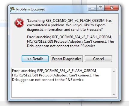

I have troubles with CW10.3 & DEMO9S08SF4 (OSBDM) under Win 7 64 bits.

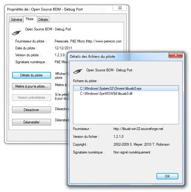

The driver seems to be well instaled:
But there is no connection:

I would suggest using the latest CW v10.5 for your development!
regarding to your problem, it seems to be a driver issue.
could you please uninstall item "LiUSB-Win32 Devices-> OSBDM/OSJTAG-..." and "Ports(COM & LPT) ->OSBDM/OSJTAG-CDC Serial port..." in Device Manager of your Windows system.
and then re-plug your board to let the PC find the driver automatically (usually, it will find several versions driver, please select the latest version).
hope it helps!

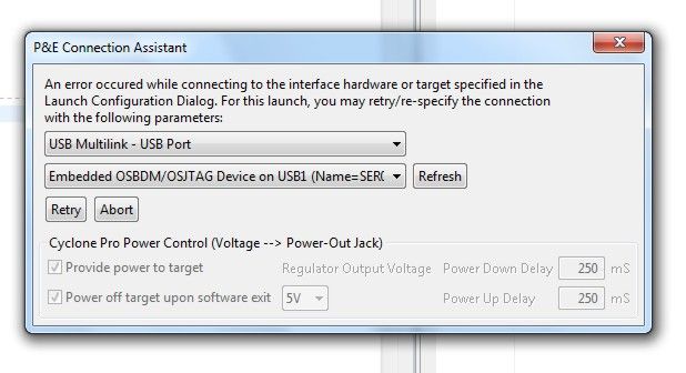

CW 10.5 installed, driver automatically installed:
But the issue is the same :smileysilly:

if the problem is still remains, then, I would suggest update the firmware of OSBDM of your demoboard.
the updater is available at:
P&E Microcomputer Systems
Please click "Firmware Updates & Recovery" to download the updater.
then connect demoboard to PC and run the updater, follow the instructions to update.
