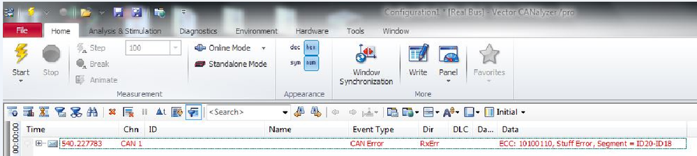

I have a question regarding the CAN message ID format. I am using CodeWarrior version 10.6.4 and the micro controller is part of the MC9S12ZVC family and I am using a USB multilink universal debugger to communicate.
How can I send a message with priority 6, PGN 0xEE00, destination address 0xFF, source address 0x18 ? I am using 0x98EEFF18UL as the message ID. This communication seems to be showing fine in CADeT but it is throwing a bit stuffing error as shown -
I can't seem to find an easy solution to this problem. I would deeply appreciate if someone could assist me with this matter.

Hello Mahendra ,
- About the MSCAN ID , there is a detail introduce :
How to use the Acceptance Filter MSCAN of MC9S12ZVC?
- Also on CW, you can create on project with Processor Expert, then add MSCAN component ,
configure the ID, in the generated code, you can find how to configure :
If still have any question , please contact us without any hesitate .
