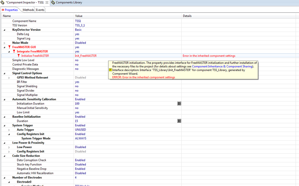

I have added TSS to an existing project using Processor Expert.  I was adding the items to each of the 'Component Inspector' selections but I am receiving the following message on the screen:
I would like to know how to fix this problem.

What’s the part number of your MCU? Have you added the Init_FreeMASTER component into the project?  If yes, could you please send me a screenshot for the properties of Init_FreeMASTER component.  It will be greatly appreciated if you could attach the whole project to help us reproduce the problem.
In addition, what is the CodeWarrior you are using? The latest version is v10.6.6, please first install CW10.6.4 which can be downloaded from:
CodeWarrior for Microcontrollers-Eclipse IDE|NXP
Its update v10.6.5 and v10.6.6 are also available at the same link.
