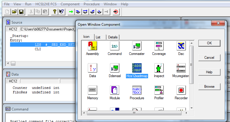

The PPAGE between $20-$3F .And If i want to erase the flash except the $3F page. what should i do for it?
besides,How to conversion between global address and logical address?

Hi Yongpan.
CW for HCS12(x) debugger defined FLASH and EEPROM in blocks. User can control FLASH/EEPROM programming with the pre-defined block, but can't with user defined block.
To check the pre-defined flash block in debugger, we need connect board with CW, then launch debugger .
In debugger command window, input FLASH command
>> FLASH
then you will see flash blocks as below for example:
   0  FLASH_4000        4000 -  7FFF   Programmed - Unselected
   1  FLASH_C000        C000 -  FFFF   Programmed - Unselected
   2  ALL_PPAGES      E08000 -FFBFFF   Programmed - Unselected
   3  EEPROM_C00         C00 -   FFF   Blank - Unselected
   4  ALL_EPAGES      FC0800 -FF0BFF   Blank - Unselected
   5  EEPROM_800         800 -   BFF   Blank - Unselected
   6  FLASH_8000        8000 -  BFFF   Programmed - Unselected
Above is all the debugger pre-defined blocks we can use later.
 Go to File->Configuration…->Load->Advanced… and select the items  you don't want to erease, then OK's, then save configuration ("File->Save Configuration")
 Close the debugger, and start a new debugger session.
Thus next time you launch debugger, then selected block will not be erased.
Regarding to How to conversion between global address and logical address, there is Hcs12xadmap tool integrated as a component in CW debugger
we can use it to calculate the conversion.
