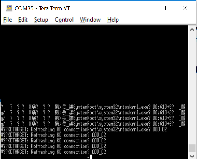

hi,
      I am trying to boot windows 10 iot on imx6q. But it is freezing in #KDTARGET: Refreshing KD connection. Please give any solution for this. I have attached the boot log.
3,774 Views
AldoG
May I ask, do you happen to get anything on your display?
You should see Windows logo after U-boot hands off to UEFI.
Message KDTARGET: Refreshing KD connection
This message is the Windows kernel debugger is attempting to connect over serial, which indicates you are making it into Windows.
Thank you,
Aldo.

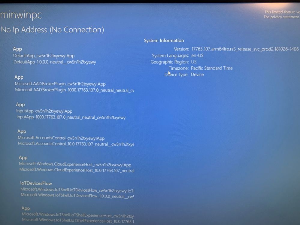

MengJu_Lin
nxf46838‌
I have a similar issue.
I use i.MX8M Mini EVK with W1860_1_0_1_NXPEVK_iMX8M_Mini_2GB_TestOEMInput-xml-Release.ffu flashed to SD card.
The attach files are screen shots of tera term and HDMI display.
It complains no IP address and stoppped. I don't have ethernet connection. How can I setup WIFI connection?tera term.PNGwindows.jpg
