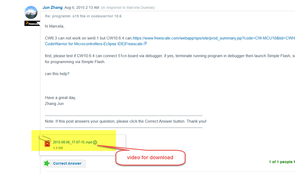

Hello, i was using codewarrior 6.3 for programm my mcf51cn128 , i load an .s19 application trhought the hiwave debugger and programm without problem, i upgrade my OS sistem for windows 8.1 i try all the metholds patchs ways of install but the hiwave didnt recognice my multilink, boring of that i  decide work instead in codewarrior 10.6 , but unfortunatelly i can't get my goal. i try the flash file to target , flash toolkit programmer, include another  excecutables; but nothing works. Some body knows any way to programm with this kind of file in 10.6 CW

hi Marcela,
CW6.3 can not work on win8.1 but CW10.6.4 can.https://www.freescale.com/webapp/sps/site/prod_summary.jsp?code=CW-MCU10&tid=CWH
CodeWarrior for Microcontrollers-Eclipse IDE|Freescale
first, please test if CW10.6.4 can connect 51cn board via debugger. if yes, terminate running program in debugger then launch Simple Flash, see attached video for programming via Simple Flash.
can this help?
Zhang Jun

Hi Zhang , thank you for answer my question; i have now instaled the CW 10.6 i can debug and conect the microcontroller but i am jet incapable to programm succesfully the .s19 i was trying with the flash file to target and the log show me thar the flash was programmed succesfully. but the skecth is not running properly i think because my sketch turn on some leds when the program works fine.
I didn't find any video attached.
Have a nice day.

regarding "I didn't find any video attached.", can you see it from your side?
