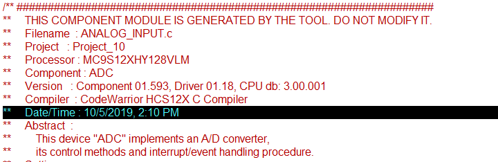

i have used cw 5.1. and i have used processor expert. when you build the cw project, it updates the date/time info which is added in comments.
i want to commit my project by git. when i build the project without changing code, github desktop software detects new changes due to date/time updates. (i used .gitignore and .o files are filtered) how can i disable updating date/time ?

processor expert doesn't have an interface that can disable this date/time information when generates processor expert code.
you can manually remove it from the source code, then disable processor expert code generation. Thus next time when you build the project, your modification will not be overwritten. But thus , you lose the advantage of pe generating code.
