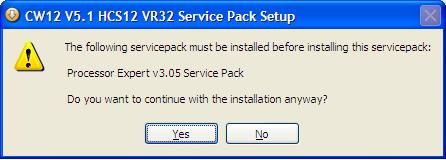

I have downloaded the latest update for Classic Code Warrior for the HCS12 processor family. (We use the S12 and S12XS processors on a range of our products)
The file name is "CodeWarrior for MCU HCS12 VR32 Service Pack v5.1 (Final).exe"
After the release Notes section, the installer tells me that the Processor Expert v3.05 Service Pack must be installed first.
Can someone kindly point me in the right direction for this please, as we have used Processor Expert in our more recent projects. And I do not want to mess this up!

I have uploaded Processor Expert v3.05 Service Pack onto Transweb, please check your mailbox and get the keywords to download it. Thanks!

Now the Processor Expert Update: V3.05 for CodeWarrior for HCS12 v5.1 is available.
All installer and patches for current versions are available through web license system.
For details, please have a look at:
    How to download a Service Pack / Patch / Update?
Pascal

By default the PE patches should be available via web license system.
The HC12 v5.1 is the last version of HC12 development tool.
There is a problem with the HC12 v5.1.
Some files are missing.
I've contacted the webmaster.
Keep you informed when the problem will be solved.
