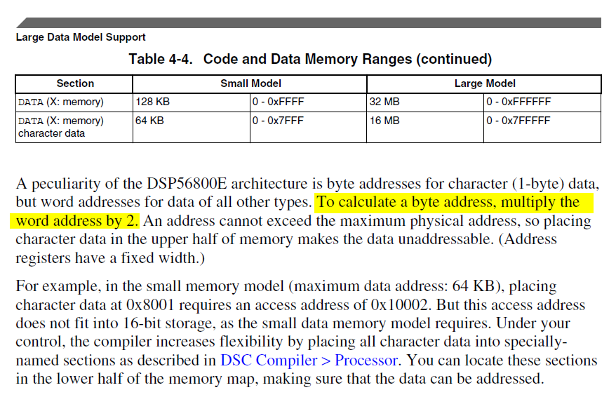

One thing I still don't get is the fact, that my precedessor uses the following line to access the char at the given location:
 p_item = (char *) (ADDR_DSP_DESCRIPTION << 1); while( *(p_item++) && (descr_length < 30)) { ....
with:
#define ADDR_DSP_DESCRIPTION        0x00002005L
Why does he shift the address one to the left? Is this related to the address space of the 56F8357?
2,575 Views
stanish
Hi Steffen,
This is indeed related to 56800E architecture. See the snippet from MCU DSC compiler manual (c:\Freescale\CW MCU v10.7\MCU\Help\PDF\MCU_DSC_Compiler.pdf):
Hope it helps.
Stan
