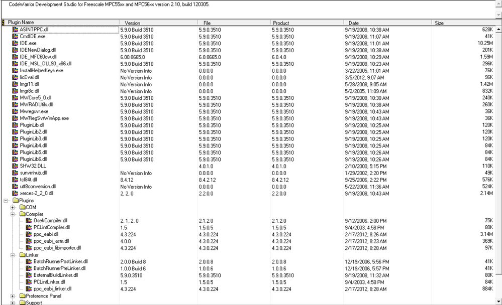

Which version of CodeWarrior are you using?
There was an issue with an overlap message when sdata2/sbss2 section moved from RAM into Flash for an older version of CodeWarrior for MPC55xx/56xx v2.x.
I'd recommend you to check with the latest available compiler (CodeWarrior for MCUs v11 - compiler version 4.3.315)
Attached are the compiler release notes.
Hope it helps.
Stan.
5,838 Views
mohammedzakari1
Hi Stan,
I am using CW version 5.9, I guess this is the latest supported version for the my controller, if you can confirm it will be great help. I am using mpc5553. please refer below snap for the Code Warrior, compiler and linker details,
If this is not the correct one, IS there anyway I can update the linker/compiler in the same CW version? or do i need to install the CodeWarrior for MCUs v11?

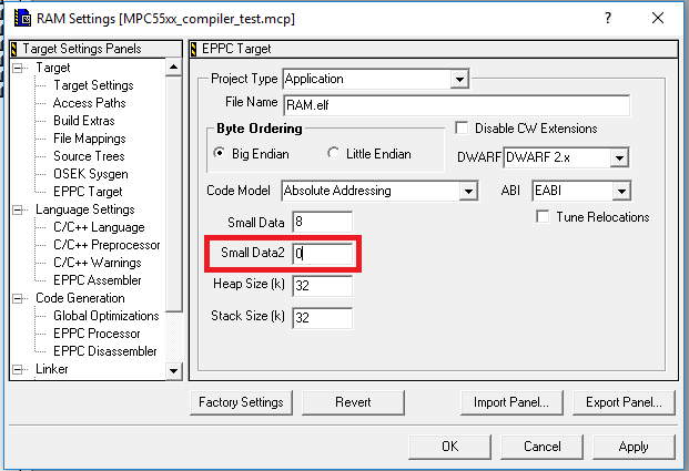

It is possible to use just the build tools (compiler, assembler and linker) form CodeWarrior for MCUs v10.X+ but it would require converting the IDE project into makefile one.
You might rather try to either disable small data section 2 generation:
or try to move .sdata2 .sbss2 into RAM instead of Flash.

Hi Stan,
thanks for the suggestions, I tried all but no luck yet, can you direct some more pointers please?
