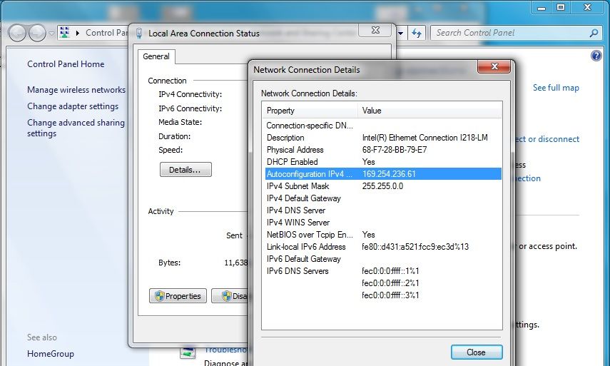

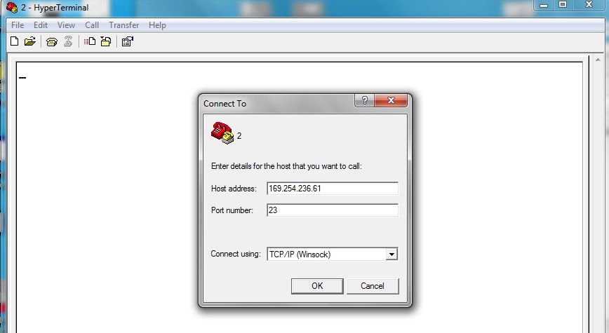

evanlim
Hi Pascal,
I’m trying to use Lan cable to connect the CW TAP to my win7 PC.
I read from the “CodeWarrior Ethernet TAP probe quick start”
that I need to configure the Ethernet connection.
After I connect the CW to my PC using Lan cable, I found the IP
address  and use that IP address.
But I’m having problem with HyperTerminal – Host address.
I had try a few other address but none can be connected.
May I know what is the Host address?
Thank you.
Evan
