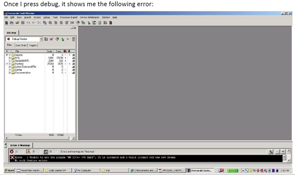

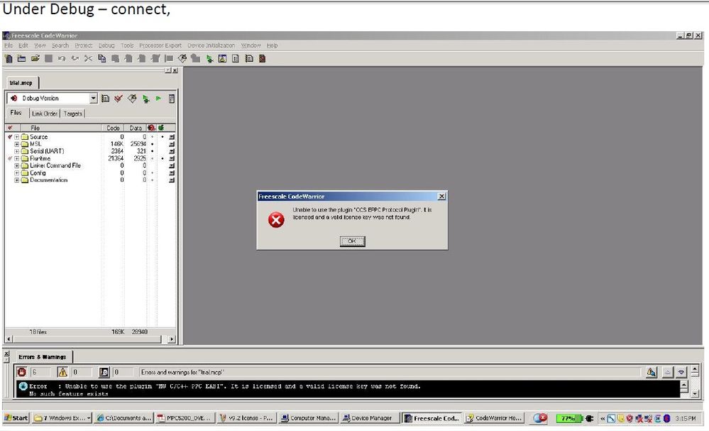

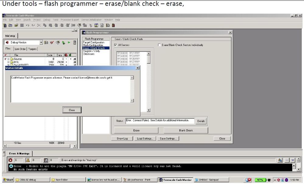

Currently, I'm using:
CodeWarrior USB TAP: CWH-CTP-BASE-HE
Software: MobileGT V9.2
OS: Window XP 32bit
  1. I had gotten the license (nodelock) from NXP
    website for my XP laptop.
Had also run setup.bat from "freescale - MobileGT V9.2 - ccs - drivers - USB -
Setup"
to install the USB drivers.
However, I'm still facing license problem(see pictures at the end).
Had also tried with changing the CCS folder and install
the USB drivers but can’t.

Hi Evan,
The Flash Programmer for MGT V9.2 is working with Basic suite or higher version.
The debugger requires higher version.
Do you have a license for this tool ?
Some months ago I've performed some tests and I was able to use the flash programmer for MGT V9.2 and MPC5125 with Basic suite license file.
Pascal

evanlim
Hi Pascal,
I’m using nodelock license.
Previously, I have the same problem with win 7 laptop. Problem solved.
However, the codewarrior tap cannot communicate with my target board.
Now, I change to xp laptop and try out.
But license problem.
I’m using MobileGT V9.2 nodelock license for xp laptop and PA V8.8 node lock license for win 7.
Thank You.
Evan

trytohelp
Hi Evan,
Do you have rehosted the license file ?
The license file is locked on a specific PC.
It could be better to continue to handle this problem via Case system.
