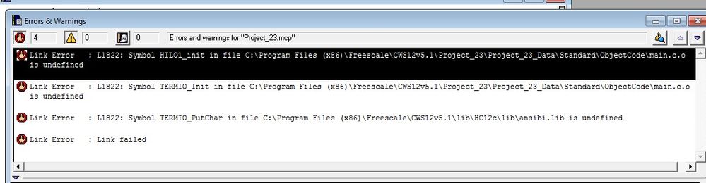

This is the error I'm getting. I'm using CodeWarrior IDE version5.9.0, build 5294.   I'm in an online class and this is for a lab to control a dc motor through PWM in a closed loop using an optical interrupter switch.  I told my instructor I was having a problem and he sent me this code which is complete and should work, but now I'm having a linking error and he's ignoring my e-mails.  I'm kind of a noob at CodeWarrior, but I think this should be an easy fix I think I just need to point these functions to the correct files(?).  I just have no idea how to do it.   Thanks!

Hello
You are missing implementation of functions HILO1_init,  TERMIO_Init and TERMIO_PutChar in your project.
In order to add implementation of TERMIO_Init and TERMIO_PutChar to your application you need to add the file
{Install}\lib\hc12c\src\termio.c to your project.
I do not know where the function HILO_init is coming from. You may have to add a library or another source file to your project.
