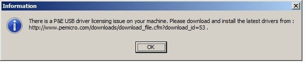

P&E Micro BDM steps: Cyclone Pro, Cyclone Universal, USB BDM Multilink*, USB Multilink Universal, USB Multilink Universal FX.
*Note: Rev. A of the USB-ML-12 is not supported in Windows 7/10 – Rev. C is supported but is discontinued product
1. Download and install the latest drivers (free login required)
2. According to this FAQ, download this zip Patch for CFV1/S08/RS08/MON08 3rd Party Software  extract it and follow the rest of steps in the README text file.
(Basically you need to merge the files from inside the "Patch" folder in the zip into "C:\Program Files (x86)\Freescale\CodeWarrior for Microcontrollers V6.3\prog\P&E".If you do it correctly, it should prompt you about overwriting a few files, do it.)
3. Run CW as administrator (using right click menu) including building and debugging/programming once.

nhpete
Pascal
I was able to connect to my s08 demo board with the P&E USB Multilink thru Eclipse v10.6, so there is apparently nothing wrong with the Multilink.  I am still no longer able to connect to the board via CW 6.3 and Rodney's work around even after unloading/reloading CW/the work around several times. This is very unfortunate since Eclipse is vastly different from CW 6.3 and will have a very steep learning curve.  I'd love to hear if anyone else experienced the same problem and if so, came up with another work around.
Tnx again for your input.
Pete

P&E Microcomputer Systems now has a solution to this problem of getting CW6.3 or other classic Codewarriors from working in Windows 7 64-bit and newer operating systems. Please read this FAQ I created and learn about which unofficial patch you should download and try:
P&E Microcomputer Systems: FAQ#211
Takao Yamada
15,528 Views
nhpete
Takao:
Thank you very much for the tip.  I downloaded and installed the s08/rs08/cfv1 patch and was able to connect to my s08 demo board in flawless fashion as soon as I completed step 4. as described on the "read me" file of the patch.  I had already downloaded and installed the latest PE drivers as part of Rodney McGee's 7/3/2014 work around (step 1. under "PE Micro Multilink BDM"), so I don't know if "read me" file step 6. would have been necessary or not.  I hope Rodney is following this thread and adds your latest detail to his work around which is really quite elegant in its simplicity.  It sure beats trying to get up to speed with Eclipse v10.6 which appears to be a powerful IDE but with a very steep learning curve.
Thanks again!

Refer to the FAQ P&E Microcomputer Systems
I've downloaded the CW63_patch_S08.RS08.CFV1.zip.
A ReadMe.txt file explains step by step the process to follow.
I did:
1. Close any running CodeWarrior applications.
2. Search the CodeWarrior application directory for the prog/P&E folder.
3. When the directory is located, make a copy of the P&E folder and rename it to P&E.backup or archive it so you can restore it at a later time if necessary.
4. Merge all files from the patch into the prog/P&E directory.
5. Restart the application debugger and try to debug your target board.
Now with the 2 interfaces under MCU V6.3, I can load the application on board.
