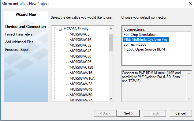

P&E Micro BDM steps: Cyclone Pro, Cyclone Universal, USB BDM Multilink*, USB Multilink Universal, USB Multilink Universal FX.
*Note: Rev. A of the USB-ML-12 is not supported in Windows 7/10 – Rev. C is supported but is discontinued product
1. Download and install the latest drivers (free login required)
2. According to this FAQ, download this zip Patch for CFV1/S08/RS08/MON08 3rd Party Software  extract it and follow the rest of steps in the README text file.
(Basically you need to merge the files from inside the "Patch" folder in the zip into "C:\Program Files (x86)\Freescale\CodeWarrior for Microcontrollers V6.3\prog\P&E".If you do it correctly, it should prompt you about overwriting a few files, do it.)
3. Run CW as administrator (using right click menu) including building and debugging/programming once.

4. You'll need to select "HCS08 Open Source BDM" in the new project wizard in CW 6.3

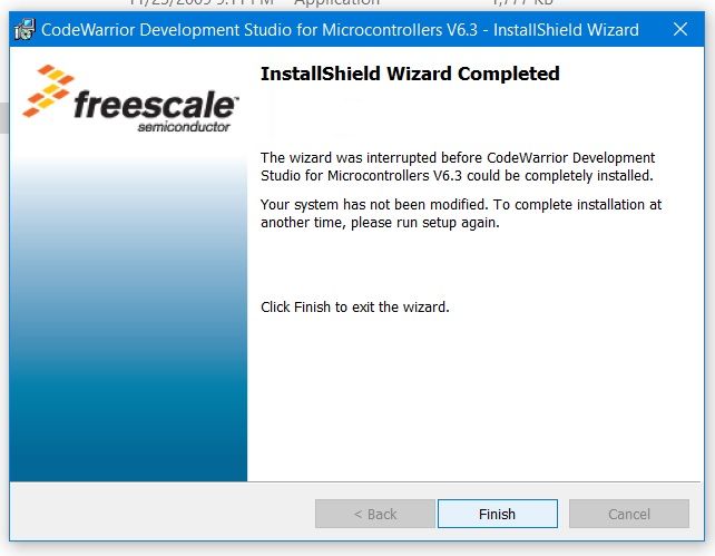

Note: This post is for issues related to the old method.
Regarding the "Wizard was interrupted ..." error:
After Step 4 (RemoveOSCheck.vbs), but before Step 5:
Step 4A: dragging and dropping CW_MCUs_V6_3.msi onto unzipped removedriver.vbs (attached as zip). Then try running the setup.exe installer again, it will still say the "setup was interrupted again" but it should have installed CW this time. Check the start menu and desktop for CW.
Step 5A:  Use the "start" menu to search for cmd.exe right click on it and say run as Administrator. (even if you are an admin user, you have to explicitly open cmd with administrative rights, Then cd into the 'codewarrior 6.3 install folder' and then cd in 'bin' and then run regservers.bat . It should says registering dlls.
Step 5B: You need to put a fresh license.dat file linked in the "License Issues or Lab Cloning" section into the 'codewarrior 6.3 install folder'
Go to Step 6 in the main instructions and continue.

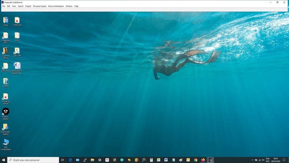

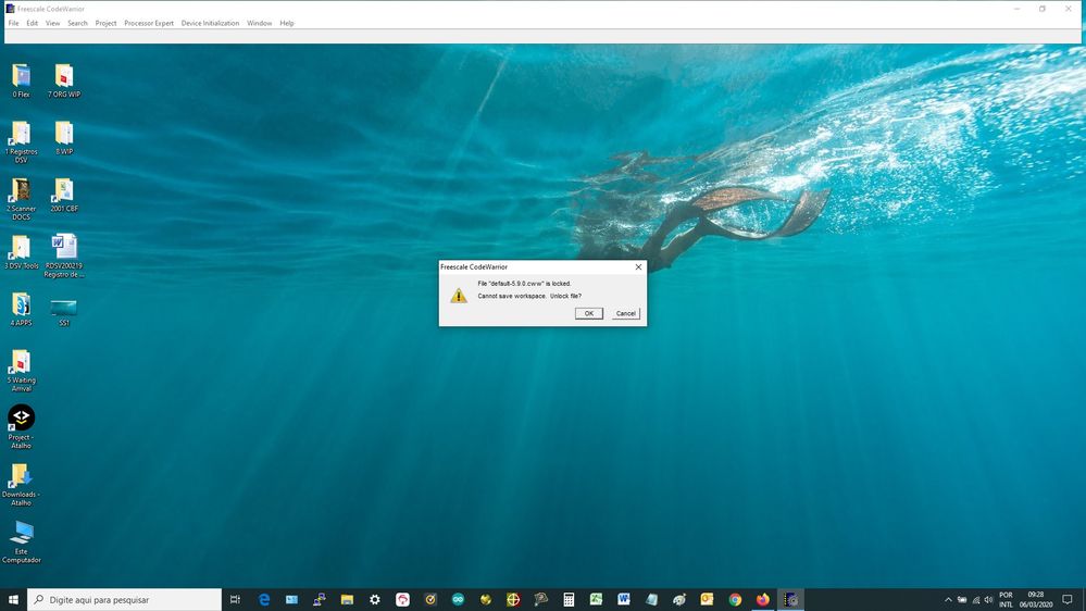

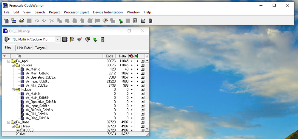

lorenzo_balli
I have a visualization issue:
Codewarrior IDE should run as a MDI form, but I see all child forms on the desktop and not in the parent container.
My system is Windows 10 x64 Ver 18.09.
How can I solve the problem?
11,445件の閲覧回数
RodneyMcGee
I have never seen this issue. Does it happen on your other windows 10 machines?
11,445件の閲覧回数
celsoken
Contributor V
Dear Rodney,
I've got the same issue on 2 Win10 machines. It runs OK (Thanks a LOT!) links with cyclone on HC08 but the main screen is the small strip shown and it does not accept resizing.
If you need additional info pls let me know.
Cheers,
Celso
11,445件の閲覧回数
RodneyMcGee
Can you post a screenshot?
Does hitting Alt+spacebar and selecting maximize do anything?
11,445件の閲覧回数
celsoken
Contributor V
Dear Rodney,
As requested, I've appended 2 screenshots. First shot is at entry, second is when exiting CW. But it's working OK, so I'm not really concerned. BTW I'm using WIN10 v 1903 compilation 18362.657SS1.jpg
Cheers,
Celso
11,445件の閲覧回数
RodneyMcGee
What happens if you run as administrator (via right click)?
Also, what does it look like when you have a project open? Does it look normal?

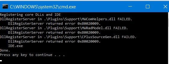

fchaudhry
Hello All,
Two more error screen shots when running the IDE for the first time.reg error.jpg
11,446件の閲覧回数
fchaudhry
Hello All,

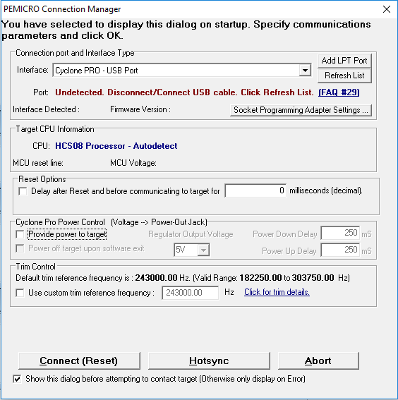

hoangthien
Hi Rodney,
I am using Windows 10 with 64bit Operating System. I have Cyclone Pro and current I have problem to connect it with Codewarrior 6.3. I followed the instruction aboved, but I don't know if I am missing any steps. The following pictures shows the microprocessor which I am using and the error message when I tried to debug my code. Capture1.PNG
Thank you
Hoang Thien
