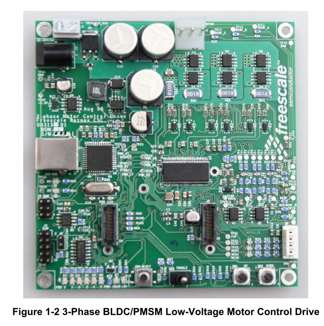

Hello, I'm using your 3-Phase BLDC/PMSM Low-Voltage Motor Control Drive and I have problem with connection in CodeWarrior Development Studio for Microcontrollers v. 6.3. I want to connect by USB cable and in CodeWarrior's debugger it's undetected. I tried all methods of connections, even HCS08 Serial Monitor where I choose COM which I'm using it can't connect. In porgram FreeMaster USB connection is visible and blinking diodes on the board show that it has connection with my computer so I think it's not problem with drivers. I'm using daughter board MC9S08MP16 and I'm working on virtual machine with Widnows XP. Please help me solve my problem. Greetings, Pawel.

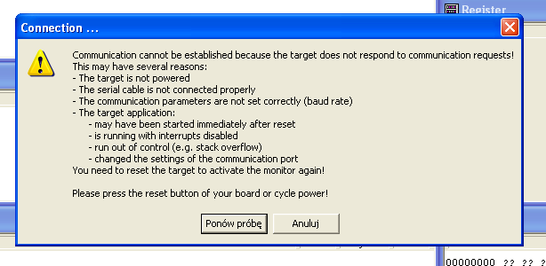

99672_99672.pngpastedImage_1.png I added screen of error which shows after try debugging by HCS08 Serial Mode.

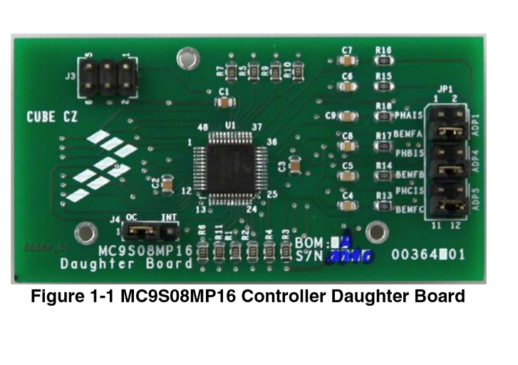

USB connector on your board is not USB-BDM adapter, which would make Codewarrior able to download code to S08MP MCU and debug it. BDM connector located on your MP16 daughter card, J3 connector, 2x3 pins header. You need to get P&E USB Multilink or something like that.
USB connector on your 3-Phase BLDC/PMSM board can be used with Freemaster software, it doesn't enable CW BDM debug communications.

You should specify what kind of USB connection you are using, at least exact USB-BDM dongle name or exact MCU board name, which has onboard USB-BDM. Is this your board : S08MP16 Demonstration Board|Freescale ?
