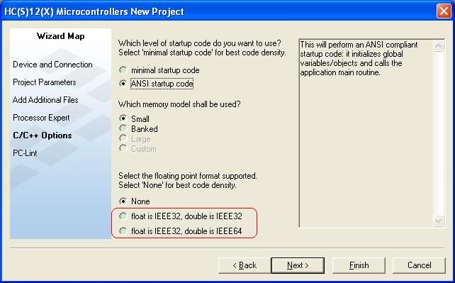

Would I be correct in saying that while I can declare a type as a double, it's really just a float.
That is the observed behaviour at any rate.

hi Dave,
this depends on what floating point format you select when creating a project.
if you select "Float is IEEE32, double is IEEE32", these two types are the same.
if you select "Float is IEEE32, double is IEEE64",  they are different.
Hope this helps!

hiswitsend
Can't find anything like that in the IDE, have tried setting a new project using the wizard and only get a choice of C, simple Assembly and C and then external or internal memory

ZhangJennie
what chip do you work with?
3,973 Views
hiswitsend
Just been checking that very thing and it appears to be limitation of the MC56F8366.
Thank you all for your replies.

kef2
Senior Contributor V
1. 5.9.0 is just a version of "editor" (IDE), not product version.
2. No it depends on compiler settings. Not sure about RS08 compiler, but S08 and S12 compilers both support 64 bit doubles. Just check you compiler settings and make sure project includes right library. Different libs are used for no float / double=64bit / double=32bit.
3,973 Views
hiswitsend
Have been through all the setting I can find and the only type related options seem to be "Enums always as int" and "use unsigned chars", nothing about floats or doubles.
Compiler appears to be 8.3.0 build 1061
