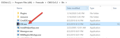

Thanks for your help. I did receive the e-mail and I have downloaded the evaluation version, but no short cut has appeared on my desktop and I don't see any .exe file in the folder that should open CodeWarrior. What should I be seeing that could open the program?
Robert
6,704 Views
ZhangJennie
You have downloaded the CodeWarrior install file. you need install it first.
If you can't see IDE icon on desktop, please follow below path to open IDE.exe.
Have a nice day,
Jun Zhang

Hi Jun,
Ahh. There it is. OK, I copied the licence.dat file you sent me and pasted it in the CWS12v5.2 folder. It replaced the licence.dat file that was there. Was that the correct thing to do? The IDE does open.
Robert
6,679 Views
ZhangJennie
Yes, That's correct.
