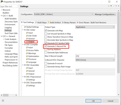

We are trying to generate a s19 file for Target MC56F8357.
We have tried using Code Warrior development studio Version 5.9.0 and  Version: 11.1. However, we cannot find any setting to create.s19 build output file.
Please advise.
Thank you.

Hi @GH13711
Please see how to generate srecord file as below:
Hope this helps,
Jun Zhang
