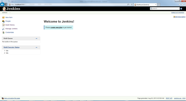

When the Jenkins installation is finished, the IE is automatically launched with http://localhost:8080/
To start Jenkins under IE I should plug it under http://localhost:8080/
If you can not access to the web page, you must check than Jenkins service is running.

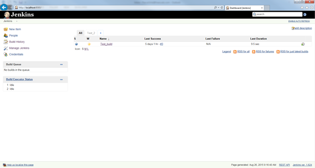

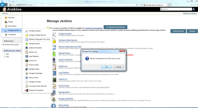

To avoid problem I've manually removed the project under C:\Program Files (x86)\Jenkins folder and performed from menu: Jenkins + Manage Jenkins + Reload configuration from disk
By this way I've a clean installation.

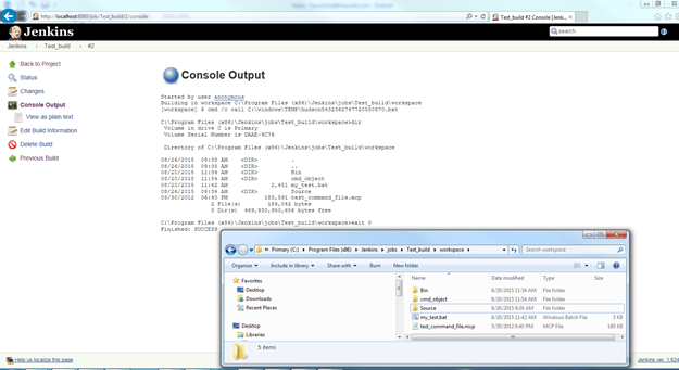

Now I've created a new item where I defined the project and added the dir command to be sure Jenkins is using the right path. I copied and extracted the zip file (Jenkins_command_line.zip) in the workspace created.
Check the .bat file is correctly configured for your PC installation (CodeWarrior Folder).
If you execute the bat file, it should work fine outside Jenkins too.
If it's not the case you must review the .bat file.

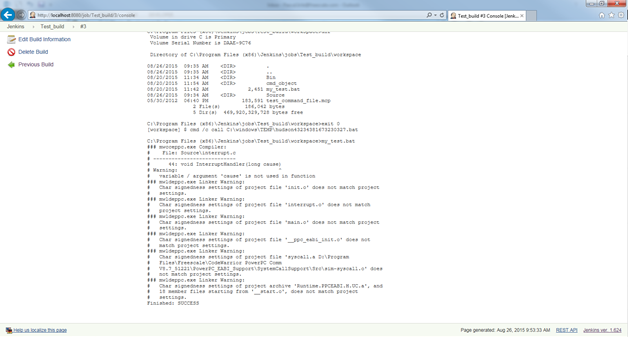

After that I added a new build step for my_test.bat.
Now when I clicked on Build Now, the my_test.bat is executed.

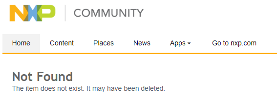

With reference to this line that you have mentioned above for using dashboard (Jenkins) to build a CodeWarrior project,
 "I copied and extracted the zip file (Jenkins_command_line.zip) in the workspace created. "
i tried to download  Jenkins_command_line.zip
but it showed :-
"Not Found"
The item does not exist. It may have been deleted.
so from where i cand download the same attachment and what does this file Jenkins_command_line.zip  contains and how will it impact the whole procedure?
I am using the S12ZVL controller. Working on an urgent project and want to integrate CodeWarrior with Jenkins as per this link https://community.nxp.com/message/1329130?commentID=1329130#comment-1329130 I have installed the Jenkins plugin and connected to the server and working fine but I want to compile the program but as per the video, not gettingJenkins_command_line.zip file. Getting below error for download.
Help me with this issue ASAP.
Thank you in advance.
Hi chaitanya.kalyani@seoyonelec-rnd.in‌,
Regarding your query, I had received reply from NXP technical support staff.
Reply - The .zip file is no longer available. The support staff also mentioned that they will try to track down the file, but cannot gurantee that it will be recovered.

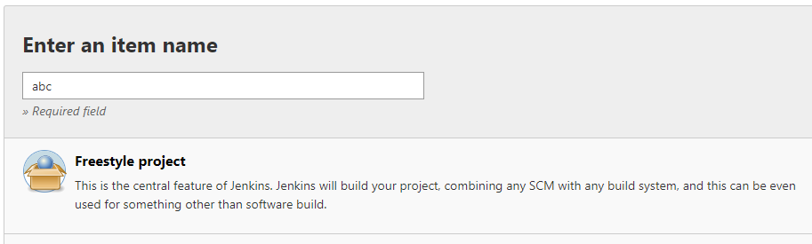

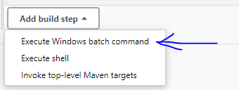

1) Enter your project name and then select Freestyle project
2) After 1st step Leave everything as default or you can customize other settings in dashboard as per your requirement and directly jump to         Build section in Jenkins.
 In ADD build step select "Execute Windows batch command"

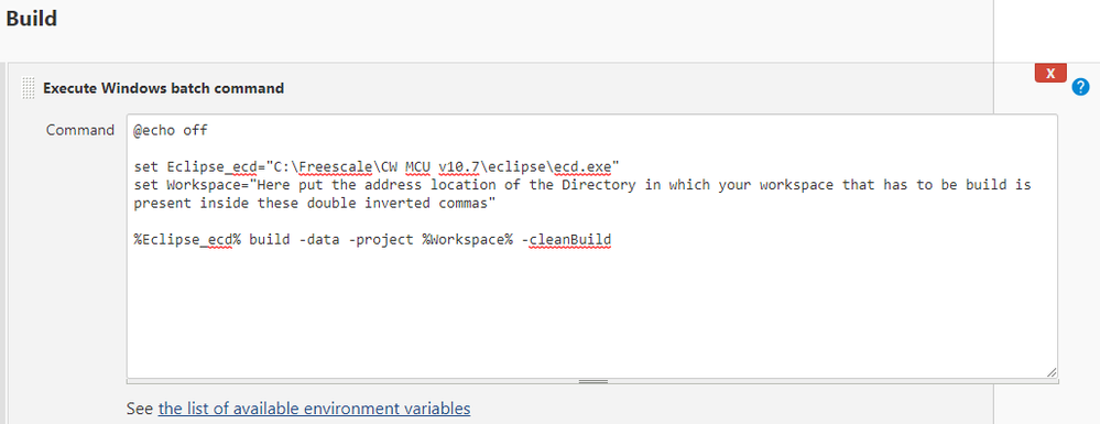

3) A command pop up box will appear where you have to write the build command using batch script for accessing ECD.exe . For     codewarrior10,  ECD.exe is present in Freescale folder structure.
In my case it is present in the path >> Freescale\CW MCU v10.7\eclipse .

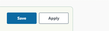

4) After that just select apply >>  save and then build.
5) After building gets completed you can check in the console output for OK build and target generation.

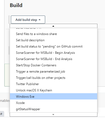

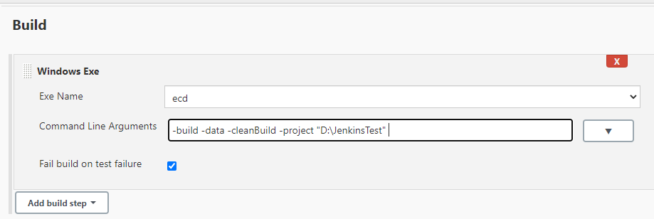

Install Windows Exe Runner Plugin from Manage Jenkins >> Plugin Manager

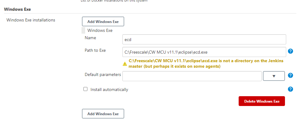

Configure ecd.exe in Jenkins Manage Jenkins >> Global Tool Configuration >> Windows Exe
In jobs for Build Select "Windows Exe"
Then for Exe name select ecd from the dropdown and give a command-line argument as '-build -data -cleanBuild -project "D:\JenkinsTest" '
for "D:\JenkinsTest" you can give %Workspace% if you want to compile program form CW workspace and remove "-project". For more
information refer to "CodeWarrior Common Features Guide.pdf"- 2.2 Command line interface
save the project and build it. That's all.
