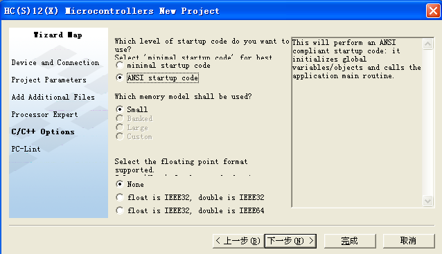

when I us PE to building a program on MC9S12HA32 by PE,I just can select memory model small

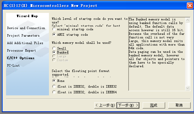

but I can select banked model when I dont us PE,like this
WHY I COULD NOT SELECT BANKED MODEL WHEN I US PE????

I just checked processor expert doesn't include banked memory support in wizard, But user can add it manually.
to change memory model from small to banked, we need
1. change build option
2. replace ansi library file
3. change memory model in compiler setting.
for detail, see attached video.
