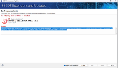

Following error is thrown when we try to install AMMCLIB for s32K3
Operation details Software being installed: com.nxp.AMMCLIB.S32K3xx.root.feature.feature.group 1.1.38.202409161322 Missing requirement: com.nxp.AMMCLIB.S32K3xx.root.feature.feature.group 1.1.38.202409161322 requires 'org.eclipse.equinox.p2.iu; com.nxp.RTD.S32K3_S32M27X.feature.feature.group [4.0.0,99.99.99)' but it could not be found

As the error message indicates, the mandatory prerequisite RTD is missing. Refer to this article how to install RTD in S32 Design Studio.
