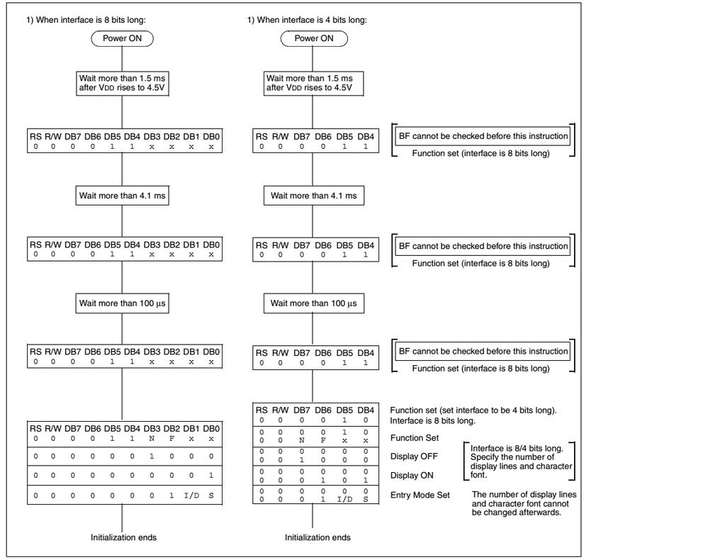

10,313 Views
avditkohli
Thanks for getting back to me. I solved that problem and have been
able to work my LCD to a certain extent. The only problem i am having is
that my output on the LCD is different every time I debug. For example if I
want to print "Logger" at times it'll print "L", '_', "Logg", "Logge" on
the same code. I have doubts on my delay/latch function. I have included my
code as an attachment
Avdit

iansmusical
Contributor V
Hello Avdit,
From looking at your code I think you haven't added the required delays in the LCD set up code nor after you write each character to the LCD. It might also be necessary to wait x milliseconds after the LCD is powered up before initialising it.
One needs a delay of 47us after each character write. The E signal needs to be 1us wide (from memory).
It would be best to check the 44780 data sheet for exact timings.
Hope this helps.
Ian

iansmusical
Contributor V
Hello Avdit,
Pleased you are making progress :-)
I don't think you need the delays in lcd_set_write_instruction() and lcd_set_write_data() because one is only setting port pins and it's only after the E signal that waits or checking the busy flag is necessary. Remembering that the E signal is what clocks information into the display.
Your busy flag check function is ok but you probably don't need to set the port as output, just input so as to read the busy flag.
You also can't check the busy flag in the display initialisation code until after a certain point. The diagram below might help:
Just remind me what lcd_write_byte(0x80) does in your while loop? I was thinking your were writing to display ram that might not be visible!?
Hope this helps,
Ian

avditkohli
Hi Ian,
The program works just fine now. You will not believe it but the LCD
module I was using required a voltage supply of 5V and while my supply was
3.3V it worked in a twisted manner or not at all. The datasheet mentioned
3.3V but on consulting the manufacturing did the necessity of using 5V
emerge.
Thanks for all your help. I am beginning my code for temperature sensing
now. Will let you know if I come up against any problems! :smileyhappy:
Avdit

iansmusical
Contributor V
Hi Avdit,
You're welcome and pleased to hear it is all working now :-) I'd forgot 0x80 was the first position on line 1 but equally I don't normally use that command because out of reset the display location should already be set there.
You'll find that most LCDs require 5v even though there has been a shift to 3.3v. There is no reason why LCD logic can't be 3.3v but driving the LCD glass is the problem and the negative supply for the contrast, although that latter can be fixed with an addition chip (sometimes present on the LCD module). I did see an article for running a 5v LCD at 3.3v but with reduced contrast. Of course it depends on the chipset and what it sees a logic 1 at etc. The other solution is to use a level converter/shifter between the MCU and LCD.
Ian
