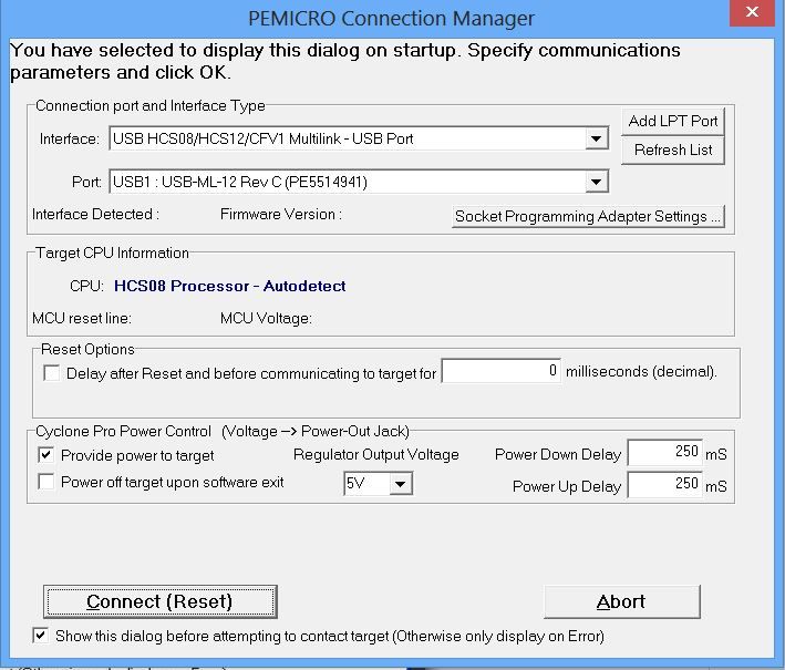

ZhangJennie
you can set trim value in PEMICRO Connection Manager before launch debugger, see attached

davidboyd
Thanks for your reply.
I must have a different or older version of the PROG software.
See the attached image.  I don't have those options.  I'm running 1.67.00.00. What version is yours?
