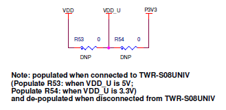

After studying the board schematic diagram also the question on how to connect the TWR_S08DC-PT60 daughter board on the TRW-S08UNIV module does not seem so obvious as in the answer on https://community.freescale.com/message/320591#320591.
In fact on the diagram there are components which may be supplied at +5 or +3.3V, jumpers to be inserted or not and at least 2 resistors which are warned they must be alternately populated in case of connection to 3.3 or 5V:
Really is it all so simple you have to do anything other than remove J10 BKGD jumper?

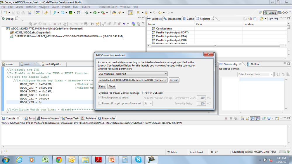

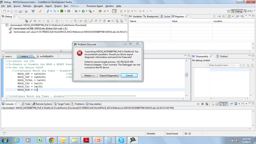

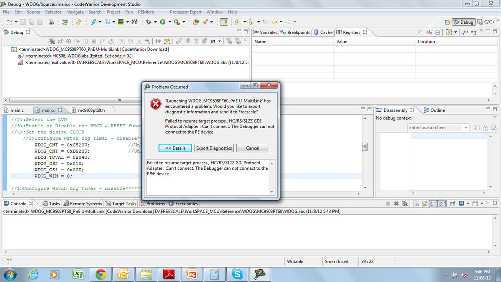

mithunp_s
HI ECKHARD/All,
I've problem with debugging TWR-S08DC-PT60 board, when I was running sample code this was working properly. I wanted to test how Watchdog resets once timeout happens, so enabled WDOG and gave value to TOVAL as below. Once I tried to load this i'm getting attached errors,I'm not getting what mistake I did....error.pngerror_continued.pngError_details.png please help me to sort this.

eckhard
Contributor V
what exactly is your Problem ? Are you new to Codewarrior or new to HCS08 or both.
You can find a lot of helpful information on this page : MCU on Eclipse | Everything on CodeWarrior, Microcontrollers and Eclipse
It´ll show you how to use eclipse and create projects with processor expert. It is allways the same, no matter which processor core you use.
Look at the schematic of the board to see where the leds etc are connected.
