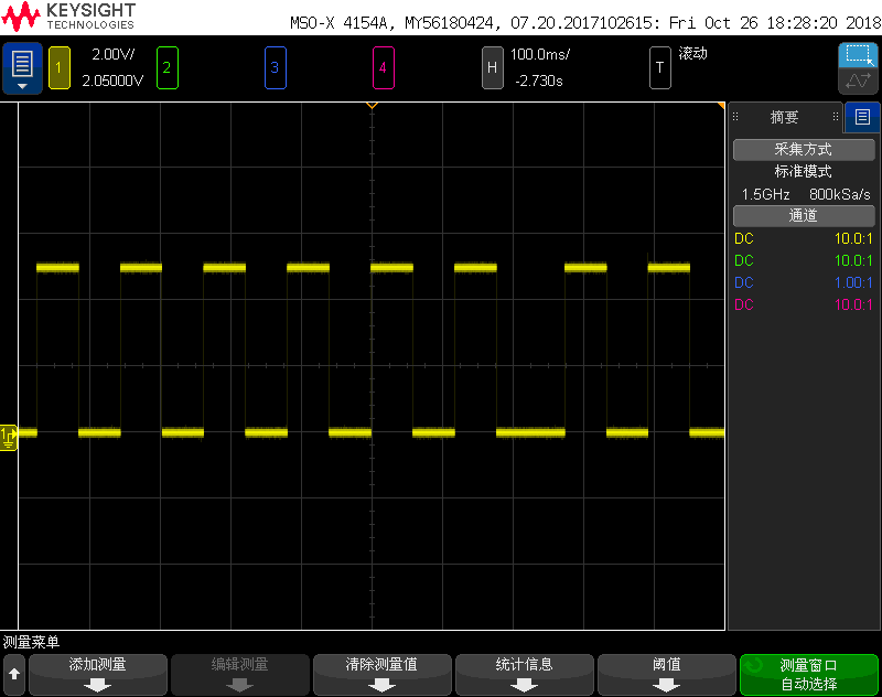

        I use the 9S08SG16 and  only configured   ICS  TPM  GPIO to confirm my ICS .
        But the output is different from what I expected.
        My code is very simple.
        void Init_ICS(void)
              ICSC1 = 0x04;
             ICSC2 = 0x00;
         void Init_TPM1(void)
             TPM1SC =0x4c;
             TPM1CNTH =0;
interrupt VectorNumber_Vtpm1ovf void TPM1_OVF_ISR(void)
if((TPM1SC & 0x80)==0x80)
TPM1SC_TOF = 0; //溢出标志位
IC1_Toogle;

I am not sure if the problem is the way that you are cleaning the flag
I normally use
void interrupt VectorNumber_Vtpm1ovf TPM1ovfISR (void)
//Clear interrupt flag
(void)TPM1SC;
TPM1SC_TOF = 0;
PTBD_PTBD6 ^= 1;
