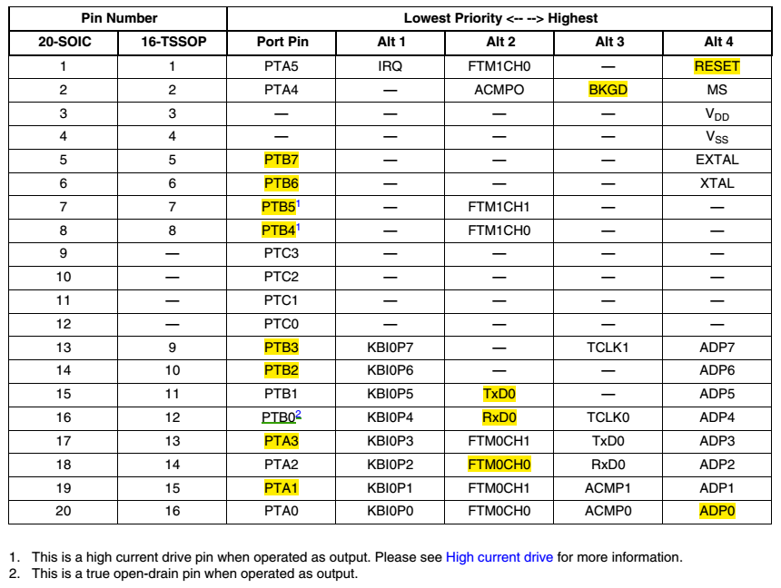

I am having problems with the SCI and Flextimer modules of a S08PA4 (16Pin). The system clock is set to 20MHz.
I just need to transmit so I deactivated the Rx part. The transmission is configured as follows:
8 Bit, Boud rate is set to156kbps, No parity and no interrupts activated (I use a polling mechanism)

With a Debugger I can see that when I call the function TX_Data() the transmit buffer is empty (flag is set) and that after loading Data_u8 in the A register the assembler command STA SCI0_D is executed but the register SCI0_D register does not change its value. Am I forgeting something? Does anyone have an idea of what is not correct?

well I found the error :smileyhappy:. It was the ADC that was wrongly configured. I misunderstood the description of the ADC_APCTL1 register :smileyconfused:. So I had wrongly deactivated all general purpose ports with the exception of one:smileyblush:. Now everything works fine as I wanted.
Oh by the way I could not see that the SCI0_D register changed its value because reading reads the read-only Data register (Rx Data register). So if one wants to control whether the information to transmit is correct or not, one would need to configure the SCI Module in LOOP mode.

Hi Vicente,
Well I want to use alt 2 for FTM and SCI. That is why I set the options register like this:
void InitPinOptions_v(void)
SYS_SOPT1 = 0x2C; /* SCI0 on PTB0 and PTB1, FTM1 on PTB4 and PTB5, FTM0 on PTA2 and PTA 3, PTA4 as BKGD function and PTA5 as RESET*/
SYS_SOPT2 = 0x00; /* Just as default */
SYS_SOPT3 = 0x00; /* Just as default */
In general the pin funtionality that I want to have is like the highlighted one. I do not need to receive anything, for that reason I configured the PTB0 as output (for debugging). But since the SCI0 is not working I could activate the pin as Rx.

Well, I checked your files and I am doing basically the same. Some differences exist like:
1. The PA4 that I am using is a 16 Pin one with only one SCI module (SCI0).
2. The flex timer we use is mapped to pins PTA2 and PTA3 (as mentioned before). Could you check if by doing this system interconection you still do not have problems transmitting?
3. I trim the µC with Cyclone Pro, so I have another trim initialization as the the one in your files. This should not make a difference since the trim values are loaded automatically during initialization. (See a portion of the Datasheet below)
I still have problems with the SCI and Flextimer. SCI0 does not work at all and Flextimer 0 works to 50% (only channel 0) if I use the default system interconnection.

Hi Omar
The PTA3 and PTA2 are the pins for the SCI0 (this is the alt 3 ) but also are the FTM0CH0 and FTM0CH1,
because of this you can not use the SCI and the FTM on the same pins, on this case the PTA2 and PTA3, please try to use the PTA1 and PTA0 for the FTM function
