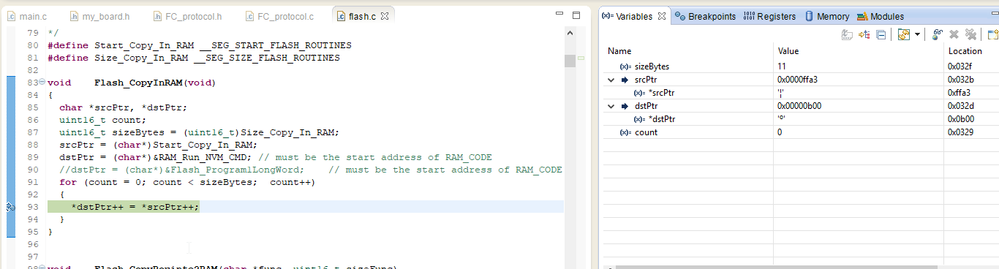

I downloaded some bootloader example code here. I am trying to modify it to work with the S08PA16 uC. I am also using processor expert.
I am not able to get the bootloader firmware to run on the target processor. This is evidenced by a blinking LED test and also the PC Host software does not communicate with the uC.
In app.c I have:
<#if 1 /* if 1 app will not run */
* Global variables
uint8_t jmp_code @0x103D = 0xcc;
uint8_t jmp_addr[2] @0x103E = { 0, 0 };
* Constants and macros
//#define BOOT_PTD0_OPTION
//#define BOOT_IRQ_OPTION
#define USE_C_VECTOR
#if defined(USE_C_VECTOR)
#define INSTALL_VECTOR(n) interrupt n void vector_##n##_ISR(void) {__asm LDHX (RELOCATION_VERTOR_ADDR+(39-n)*2); __asm STHX jmp_addr; __asm PULH; __asm JMP jmp_code;}
#endif
#endif>
As the comment suggests, if the C code for vector remapping is in place, the app will not run.
Any suggestions would be appreciated.

I am continuing to make progress. I am able to load the boot loader and connect to the PC app Freescale - Universal Bootloader AN2295 $Version: 10.0.13.0$
Unfortunately It seems that the SDID 0x42 for the S08PA16 is not supported in the PC application?
Any assistance would be appreciated.
Here is the output from the PC bootloader app.
Waiting for HC(S)08/ColdFire/Kinetis reset ACK (timeout: 6s)...received 0xfc (good).
WARNING! The SDID of the device [0x042] is not (yet) supported!
Check AN2295SW for update!
Bootloader protocol version: 0x02 (S08, read command supported)
CRC protocol NOT supported)
Bootloader version string: S08P
System device ID: 0x042 [unknown derivative] rev. 0
Number of memory blocks: 2
Memory block #1: 0xC000-0xF3FF
Memory block #2: 0x3100-0x31FF
Erase block size: 512 bytes
Write block size: 128 bytes
Original vector table: 0xFFB0-0xFFFF
New vector table: 0xF3B0-0xF3FF
5,591 Views

I have made some progress by modifying the example you sent. I am now able to load and debug the bootloader. However, I am getting stuck at the flash copy as shown in the screenshot. Line 93 just hangs forever.
Any pointers would be appreciated.
