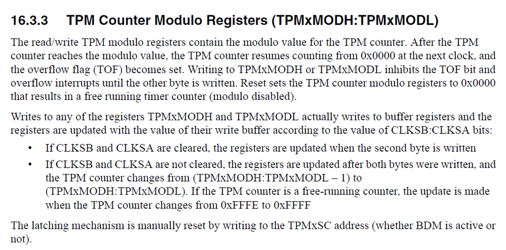

QE8 has TPMv3 (as opposed to TPMv2 in AW60) a critical difference in these two versions is a latching mechanism added to the modulo and channel value registers. When they are written, the value is actually latched in a buffer and later updated to the actual register when the timer counter reaches the last count. This mechanism is there to prevent glitches in PWM duty cycle or frequency updates, in other words, the value will in fact become updated, on the next period. More info in the reference manual:
Also notice that you can override this latching mechanism by temporarily turning off the timer clock CLKSB and A = 0, updating and turning them back on.

Thank you for your answer. I had noticed about v2 and v3 but didn't realise the differences were the latching mechanism. I had also read section 16.3.3 a few times and felt that as I'm using the bus clock, CLKSB (0) and CLKSA (1) would therefore be not cleared and thus the update would naturally occur via the latching mechanism when the counter changes from max - 1 to max. This I haven't seen occur or is it additionally necessary to write to TPMxSC or temporarily turn off the timer clock, as you suggested to defeat the latching mechanism?

If you are reading, are you reading with the BDM active (in other words, are you debugging at the same time?), the parargraph just below the screenshot I posted before explains that in BDM active mode, the latch is frozen, so if you are reading with BDM, you would read back the first value.
