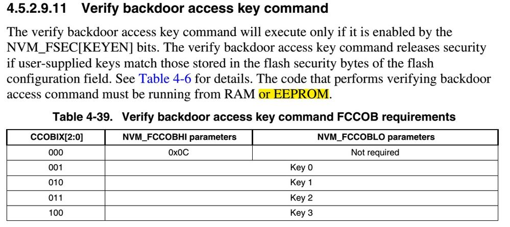

Edward gave me some information and I think I understand better how it works. But anyway I was not able to implement its suggestions.
Now the question that I have is that according to the Datasheet of the S08PA4 it is also possible to run the backdoor key command from EEPROM (please see image taken from MC9S08PA4 Reference Manual, Rev.3, 08/2014 some messages below.
Can you confirm this? Is there any restriction when doing it from EEPROM?

yes should be possible, unfortunately I do not have sample code, but the only difference is that you need to run from EEPROM, I believe that this can be set on code-warrior on the linker, but code warrior stuff are not my area.

1. It is absolutely necessary to run code from RAM  or separate EEPROM or separate flash memory bank or external memory while any flash command is being executed (including unsecure, erase verify and any other commands). Failing to do so will make code memory not readable by CPU while flash command is being executed, and as a result CPU will runaway into the weeds.
For the same reason, since most likely your interrupt vectors table is in the flash, also most likely your interrupt service handlers are also in the flash, you need to not forget to disable interrupts while any flash command is being executed.
Not whole unsecure routine has to be copied to and executed from RAM. Only the part of code which launches flash command (FSTAT = 0x80) and waits until FSTAT bit 7 is set again. Once FSTAT bit7 is set, you can return back to flash.
2. NVM_FSTAT = 0x80; launches flash command. It is correct to execute this line after all required writes to FCCOB and FCCOBIX are done. Not the opposite.
3. Yes, it's necessary. Flash controller uses its clock to sequence all flash command timings. I doubt flash unsecure command is possible with wrong flash module clock.

It is possible to read from flash Flash and EEPROM memory while commands are being executed on EEPROM memory. It is not possible to read from EEPROM memory while a command (erase/program) is executing on flash memory. Simultaneous EEPROM memory are implemented with error correction codes (ECC) that can resolve single bit faults and detect double bit faults.
Don't know if there's a more recent document. They mention only erase/program in (), but I think it applies to all flash commands including backdoor key unsecure. Could be checked, but {fstat=0x80; while((fstat & 0x80)==0){} } code is very small and you always should be able to find space in RAM to be able to copy and execute it from RAM.
Your code is wrong. Again,  line 3 in the body of your verify function  NVM_FSTAT  = Sys_D_BIT7;  have to be removed. You are launching flash command here while FCCOB data is not yet defined. This most likely triggers one of errors bit in FSTAT reg. Then, after you fill FCCOB and launch flash command again, your command is ignored since you have some FSTAT error bits set. Try debugging it in unsecured mode, you should see if FSTAT errors are triggered.
This part of your routine should be moved to separate function and executed from RAM

In point 1 you wrote "... or separate EEPROM ...". What do you mean with "separate"? I am running the command from internal EEPROM (only the code that launches the backdoorkey command lies inside the EEPROM nothing else). Do you mean an external EEPROM outside the mC?
I also double checked that I deactivate the interrupts before launching the command (I do it even before I call the function that verifies the sequence). So the code looks like this now after adding some parts given from Vicente. I added here the exact definition of some defines that I use, so that every one could understand better what I am writing to some registers.
