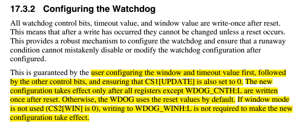

Hi every one,
I am experiencing problems with the Watchdog of a S08PA4. I configure it like this just right after power on (so the 128 clocks condition is met):
  Os_F_DisAllInterrupts_v();
  Sys_f_InitCLKModule_v();  /* Initialize clock module ( Bus clock set to 19,2 MHz)  */
  WDOG_TOVAL = (uint16_t)32000;
  //WDOG_WIN = ZERO_U8; /* This is not necesary since I am not using window watchdog */
  WDOG_CS2 = 0x42;
  /*( Sys_d_WDOG_CS2_WIN_OFF| Sys_d_WDOG_CS2_IRQ_FLAG| Sys_d_WDOG_CS2_256_PRESCALAR_OFF| Sys_d_WDOG_CS2_CLK_IS_BUS_CLK); */
WDOG_CS1 = 0x84;
  /*( Sys_d_WDOG_CS1_WD_ENA| Sys_d_WDOG_CS1_WD_IRQ_DIS| Sys_d_WDOG_CS1_UPDATE_OFF| Sys_d_WDOG_CS1_TST_DIS|
      Sys_d_WDOG_CS1_IN_DBG_ON| Sys_d_WDOG_CS1_IN_WAIT_OFF| Sys_d_WDOG_CS1_IN_STOP_OFF );*/
  Os_F_EnAllInterrupts_v();
After this I initialize all the application modules and go to the Cyclic mode. There I refresh the watchdog using the following function:
void Os_f_FeedIntWD(void)
  WDOG_CNT=(uint16_t)0xA602;
  WDOG_CNT=(uint16_t)0xB480;
  Os_F_EnAllInterrupts_v();      /* the sequence 0xA602, 0xB480 will reset the watchdog */
After reading in other threads I understood that while debugging, one should not set a brakepoint (BP) or step inside this function. So I placed a BP right after returning from this function (no other BP was active). The System starts but does not reach the BP and the Debugger shows reset and I loose connection to the µC. When I place a BP during the initialization of the application I can see that the time is correct. I mean, the refresh point is not too late. I can even set a BP just before the refresh function is called the first time and it is reached.
Am I missing something?
Can anybody find a mistake in the way I am initializing the watchdog?
I have tried using other timing configuration like using bus clock or the 1KHz bus clock and offcourse modifying properly the WDOG_TOVAL. I have even made a stand alone version (no debugger connected) with the Debug-enable bit set to zero and the result was the same (the application does not run).
When I deactivate the watchdog and its refreshing function, the application runs without a Problem.
Please I have no idea what else I can do.
Omar

Hi Omar
Please try with
WDOG_CNT = 0xC520;         /* First part of the WDG unlock sequence */
WDOG_CNT =0xD928;         /* Second part of the WDG unlock sequence */
  /*  Initialization of Init_WDOG */
  /* WDOG_CS1: EN=1,INT=0,UPDATE=1,TST=0,DBG=0,WAIT=1,STOP=1 */
WDOG_CS1 = 0xA3;
  /* WDOG_CS2: WIN=0,FLG=0,??=0,PRES=0,??=0,??=0,CLK=0 */
WDOG_CS2 =0x00;
  /* WDOG_TOVAL: TOVAL=0xF800 */
WDOG_TOVAL =0xF800;
Also you can use processor expert to set the WDG
I hope this will help you
