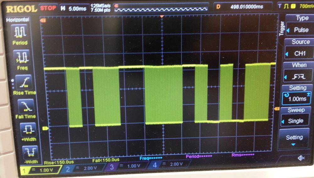

We are using TPM1 and TPM2 to generate an FSK modulated stream of 1s and 0s. TPM1 is responsible for the bit timing (when the frequency needs to change) and TPM2 generates an edge-aligned PWM output that shifts between two frequencies – each representing a 0 or 1, we’ll call FREQ_LO and FREQ_HI, respectively.
The baseband (demodulated) data is essentially a UART format with 1 start bit, 8 data bits, 1 parity bit and 1 stop bit. When there is no data  to be sent, the idle state is 1 (aka FREQ_HI). I don't think this is important, but I thought I would share anyway.
The majority of the time, the system operates as expected, but randomly, the TPM2 stops modulating one of the frequencies.
For example, if the bit pattern 0-1-0-1 was to be modulated, the TPM2 output would output
DC -> FREQ_HI -> DC -> FREQ_HI, where DC is either GND or VCC. I suspect the DC level is an artifact of the last output state before the frequency (modulus) was changed.
I have scope captures of when the FREQ_LO is at a DC level. Note: I am unsure of whether the issue happens for the FREQ_HI bit time in other situations.
To fix the issue, we have tried to turn it off and back on by disabling all interrupts, refreshing all the TPM registers and re-enabling the system. This does not seem to fix the issue.
In some situation, the issue has been seen to correct itself, although we cannot correlate when or why. In other system, the issue continues for weeks and never corrects.
The only course of action that always fixes it is power on reset.

Problem solved!
The source of the error was found with the timer responsible for generating the two FSK frequencies out the output pin, TPM2.
The TPM timing system uses three registers in the output compare toggling mode: Counter (TPM2CNT), Modulus (TPM2MOD), and Value (TPM2C0V). The modulus register determines toggle frequency by controlling when the counter register should reset to 0. When the Value register matches the Counter register, the configured action will take place. In our application, the output will toggle.
In our firmware, the Counter register was never initialized because the reset value is 0. In a function that turns off the FSK system, the Value register was inadvertently being modified after the Mode Select field (TPM2C0SC_MS0x) was being set to 0. Mode Select 0 sets the timer to input capture, which loads the current Counter register value into the Value register. If the value loaded happens to be higher than the modulus value, the output would never toggle the next time the FSK was re-enabled.
The clearing of the TPM2C0SC_MS0x field was removed and the Value register is explicitly set each time the modulus is changed. This solved the issue.

That sounds like what happens when you change the modulo register to a value that the counter has already passed.  It won't hit the modulo value again until the counter overflows.  I'm looking at some HCS08 code I wrote years ago for AFSK and it waits and polls the timer flag (with interrupts disabled) to see when it's reset and then sets the new modulo value at the same point every time.
If your frequencies divide evenly into your bit rate and the code that sets the new modulo value is synced only to the bit rate timer and not the FSK frequency timer, I can see that problem persisting for long periods because you'd be setting the modulo register at the wrong moment every time, until maybe some random interrupt gets things sufficiently out of sync again.
