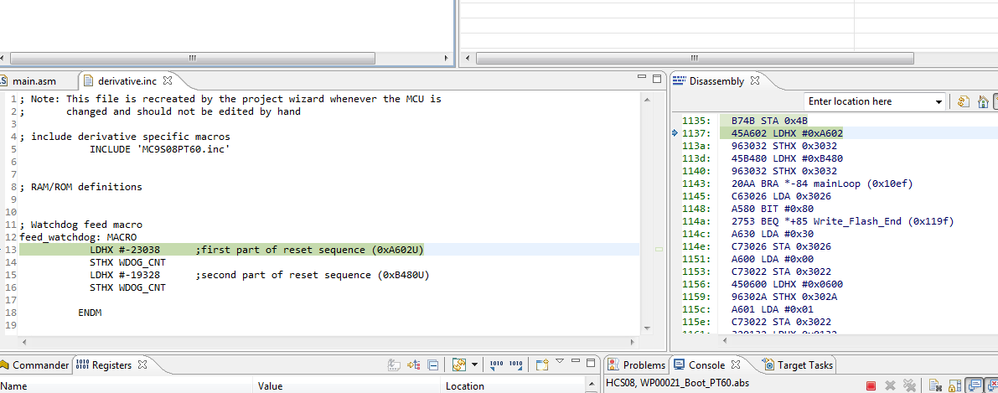

I have inizialized the WDOG with:
ldhx    #$C520
sthx    WDOG_CNT
ldhx    #$D928
sthx    WDOG_CNT
movx    #$04, WDOG_TOVAL
movx    #$00, WDOG_CS2
movx    #$80, WDOG_CS1
cli
mainLoop:
nop
feed_watchdog
bra     mainLoop

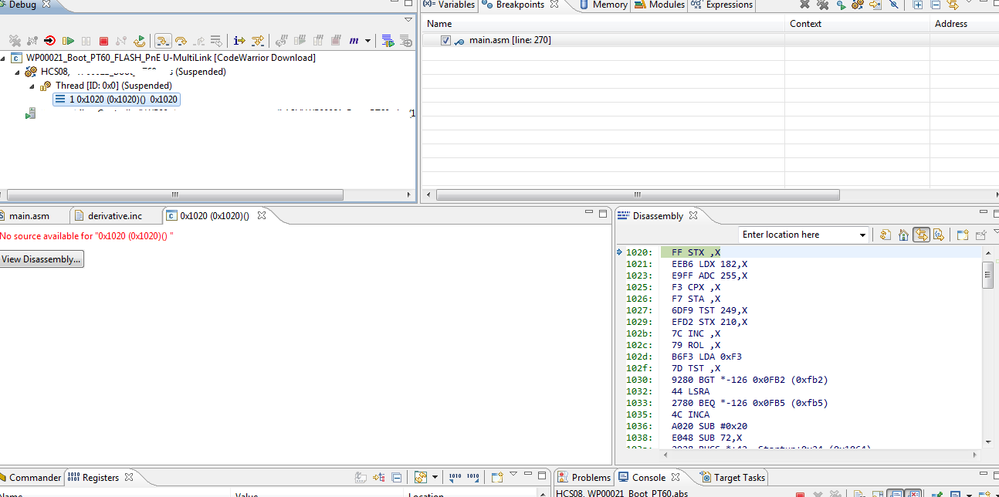

The problem is when I Suspend the excution and go by step, when execute the sthx WDOG_Cnt instruction the execution goes at random address !!
After the next 2 step:
How can i solve this problem ?

HI
you should never step through these sequences, allways go over and keep this atomic, there is limit of just few bus clks see the related info from ref manual below
Pavel
23.3.1.2 Refreshing the Watchdog
The refresh write sequence is a write of 0xA602 followed by a write of 0xB480 to the
WDOG_CNTH:L registers. The write of the 0xB480 must occur within 16 bus clocks
after the write of 0xA602; otherwise, the watchdog resets the MCU.
Before starting the refresh sequence, disable global interrupts.
Otherwise, an interrupt could effectively invalidate the refresh
sequence if writing the four bytes takes more than 16 bus
clocks. Re-enable interrupts when the sequence is finished.

Yes, I followed all that religiously, and got an immediate [WDOG, RESET, Illegal Opcode, Illegal Address, etc] interrupt on the first write when I stepped through it.  With the option to enable WDOG in chip debug mode, I assumed stepping through would be OK, especially since the clock source is the bus clk.  I'll take your advice and just run through that process.
