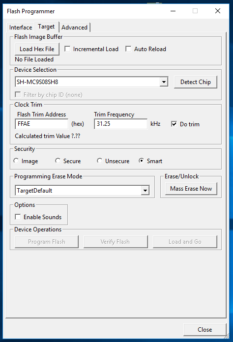

I need to program a MC9S08SH8 microcontroller with Codewarrior 6.3.
In the past I used  PEmicro and I set 32MHz in the DCO Output frequency (see picture attached).
At the moment I don't have the possibility to use PEmicro and I would like to maintain this setting also on Codewarrior.
Is there this possibility?

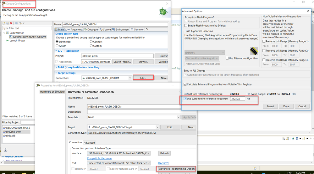

Actually I'm using this evaluation board to program the microcontroller:
https://www.nxp.com/products/processors-and-microcontrollers/additional-processors-and-mcus/8-16-bit...
I've already tried to modify the parameter in debug configuration but it has anyway an higher clock. I can understand it because the answer in the UART port is faster than 9600kbps (as setted). It seems almost 5% higher.
In parallel I've tried to use the USBDM interface with its software. With its clock trimming setup it works!
So, what I would like to know is:
-why the evaluation board can't set the correct clock frequency?
-Is in your opinion the USBDM interface reliable for programming? Also for production? I'm asking this because it seems that it's an open source hardware and software.

vicentegomez
you can use Processor expert or device initialization, but this is creating a code.
Also there is a tool that you can set the TRIM value, maybe this can help you, you can set the internal clock with a value between 31.250 to 39062.5 Hz please check the image attached.
Debug configuration/edit/ advance programming options / use custom trim...
