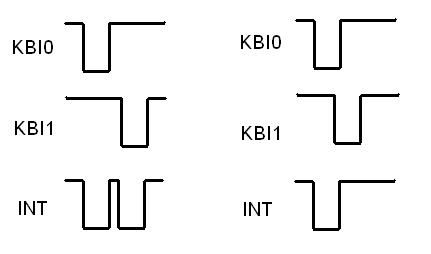

Hello! We have a product based on Freescale MC9S08QE128 MCU that uses 2 KBI interrupt pins to determine time difference between certain related external events that are a few (2-20) milliseconds apart. As KBI interrupt fires our KBI ISR loops while KBF == 1 disabling any asserted KBI pins and setting KBACK = 1 effectively making sure that when we leave KBI ISR we are ready to receive new KBI interrupt. The problem is that sometimes after the first interrupt fires the second interrupt does not. I studied KBI block diagram and I understand that any enabled asserted KBI pin will prevent generation of new KBI interrupt. But it seems to me there is a potential MCU bug where even if asserted pin is disabled it prevents generation of new interrupt. This same behavior was mentioend by Javier Rodriguez in "MC13213 : Problem using KBI interrupt" thread. Assuming this is MCU bug is there a workaround besides polling of second KBI line after the first interrupt? Thanks!

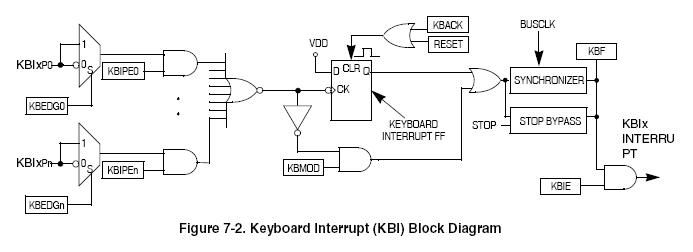

Guys, thanks for all your help. Once I switched to edges and levels KBI detection mode the interrupts started working reliably. I am pretty sure the problem is with the signal that is supposed to generate an interrupt and not with MCU KBI implementation which seems to work just as described by above mentioned diagram. Thanks again!

The interrupt sources are independent. There is plenty of time between them (on average 7ms) that there should not be a case where KBI1 interrupt arrives while KBI0 is being handled. I can poll the lines after the first interrupt fires and I can see that KBI1 line is not asserted when KBI0 is already deactivated (I perform this check in main() ). Then some time later it gets asserted but I don't get an interrupt (which eventually arrives but about 20 ms later).
Maybe more clarification would help. My interrupt sources come from sort of window comparators. Once certain measured value goes outside of predefined window they pull the output low otherwise they stay high. During my measuring cycle the value can go back and forth but I am interested in the first "out of window" occurrence on each channel and the time difference between those two events. I think this problem is somehow related to KBI0 line going through asserted/deasserted states although being disabled during the first KBI ISR call.

If you look at the diagram, as you said, the first interruption of the KBI should return to its inactive state because all KBI inputs converge in an OR gate, therefore, can not activate a new interruption before releasing the previous one. If the first remains active while the second arrives, it will not detect the latter. The mode of operation of the KBI (edge or level) is after the OR gate. Again, you should use two interruptions.

This is what I see may be happening. In the first case, the interruptions do not overlap or also may be that your comparator outputs generate an edge. In the second case would be superimposed interruptions or your comparators maintain the state more than 20mS until the comparison is reversed.

Well, it's a way out, but if you look at the scheme before entering the OR gate goes through an AND to enable / disable the corresponding pin, this works well, I used the KBI. Normally, when you have more of an interruption in the KBI, you must verify software, which of all the entries that have enabled is the one that generated the interrupt. Perhaps the flanks are not as expected at some point.
