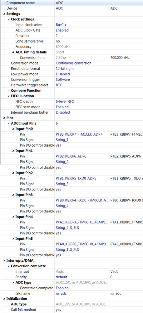

Hello everyone,
I've a problem to read the ADC Result with FIFO mode. I need to read AD7,6,5,4,1,0 and I set with the Processor Expert the parameters reported in the picture:
Here the generated Init code:

With the above reading of the result (ADC_Result_Buffer [i] = ADC_R), I obtain only the value of the CH7 (i.e. the initial channel, ADC_Channel_Buffer[i]=7).
How can I do a reading of the other channels?
