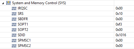

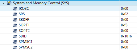

I discovered that I caused the POR due to disconnected power to the device when I read the SRS register. The only flag that is set when I perform the ILOP is the LVD flag in the SRS. So I still don't know why the ILOP flag isn't setting. The LVD should not be set as the LVDE is disables, to the LVD circuit is disabled. I have attached screenshots of the 3.3V vs the 5V which so the system and memory control registers. Both the 3.3V amd the 5V are running the exact same bootloader and application code.
3.3V Version
5V Version
Second Update
So I took the 5V board and regulated the supply voltage to Vdd and Vss. The ILOP flag does not function below 3.4V. Below 3.4V, the only flag that sets using illegal opcode to cause a reset is the LV flag. I think a Freescale engineer needs to get involved with this. For the interim, I am am going to clear my applications checksum to force the bootloader to take over after the reset.
