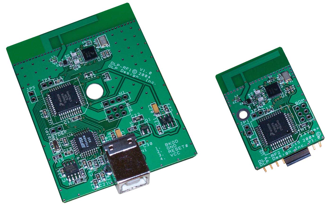

Hi Guys,
I'm intending to use 2 boards of DLP designs (http://www.dlpdesign.com/rf/rf1.shtml) and one of them has a MC9S08GT60 on.
I will need to modify the firmware on the uC in order to make the ADC to work. Therefore, I would like to know wich one of the In circuit debuggers/programmers is the best in this case. (M68DEMO908GB60 , USBMULTILINKBDME , M68CYCLONEPROE, M68MULTILINKS08, etc. )
In addition, is it possible to "upload" the firmware that is already in the uC to the PC to edit it on the In Circuit programmer/deugger software? Or I will need to ask the DLP guys for the firmware source files?
Thanks in advance!

Hi and welcome Ed,
The DEMO908GT60 is a board similar to what you are buying, it will not assist you to programme/debug.
The USBMULTILINKBDME is the same as the P&E USB-ML-12 that they speak of in the datasheet of your board. This is most likely what you want. You can get it from Freescale or direct from www.pemicro.com.
The Cyclone Pro is just a super-duper version of the above, but it is unlikely you will need all of its "bells and whistles"
Finally the MULTILINKS08 is like the second one but printer port interface rather than USB.
I really think the USB Multilink is best suited for you.
You can also get a free version of Codewarrior IDE from this site. Perhaps the new 6.0 version (or 5.1)
You may be able to upload the code from the board if they have not secured it, but it would be far easier if you can get the source from them.
Good Luck!

Hi again Peg.
It seems that I will need to buy and solder a connector (BDM connector?) for the DLP boards...
As they say on their "datasheet" :
"The MC9S08GT60 can be reprogrammed (if desired) with user-supplied firmware via a 6-pin BDM
header that is compatible with the P&E USB-ML-12 and other device programmers (purchased
separately)."
Please follow the link to see the board pics with the holes for the connector:
http://www.dlpdesign.com/rf/images/rf12fam.jpg
So... Will I need to buy and solder this connector? Just to make sure...
And when I read the USB multilink datasheet, it only says about motorola microcontrollers... Are you sure that the "USBMULTILINKBDME: USB HCS08/HCS12 BDM Multilink - In-Circuit Debugger / Programmer" supports  MC9S08GT60 ? Just to make sure as I will order online to be delivered in Australia.

peg
Senior Contributor IV
I am just about to go out so a quick reply.
Everything is OK about what you say.
Freescale was Motorola.
You can buy just some double row header pins for the connector as 6 pin sockets are hard to come by.
Will quote you a source later as I am in Sydney Australia.
