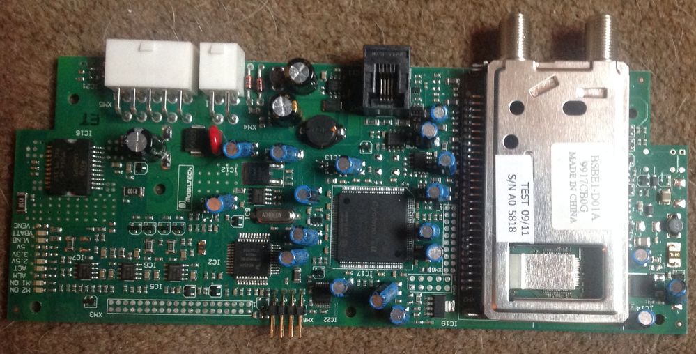

egoodii
Senior Contributor III
You're right -- there isn't much else there(!).  All I can say is if I search BSBE1-D01A I find Linux drivers that seem 'appropriately complicated'.  I'm afraid we may be dealing with a NIOS processor compiled into the FPGA and doing the major setup for the tuner.  I will dig a little deeper into the code you've got, but I don't expect to find much.  For instance, the Linux header looks to indicate about a hundred 'registers' to set up in the tuner...

The strange thing also is that the BDM port doubles up as a FPGA port as well to a cyclone 2 EP2C5T144C8 note the 8 pin header bottom centre
The manufacturer updated these once before and used a cyclone pro which I have now bought but I had hoped it may have helped find comments listing the satellites as a clue.
The rj45 goes to a control unit with LCD display
Here is a photo of the board and a link to the user manual http://www.mobilsatplus.it/images/stories/files/User%20Manual.pdf
