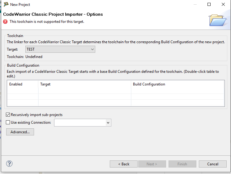

I'm using CodeWarrior Development Studio 11.0.1 Build Id: 180609
MCU: MC9S08QE4
I try to import an old CW 6.3 project file (.mcp) to the new eclipse based CW 11 project. I was very happy to see, that CW 11 supports an import functionallity for legacy CW projects. But I get an error (This toolchain is not supported for this target) and I don't know what to do next.

I followed these instructions, but the error is the same:
Could you tell me what specific toolchain settings I have to setup in my legacy CW project target?

The project importer is not compatible with S08 MCUS, it is for DSC processors only.
If you want to migrate your classic project to CodeWarrior 11 I would recommend you follow these steps:
  • Create a new project in CodeWarrior 11 selecting the corresponding target and configurations.
  • Copy the source files from your classic project to the new eclipse project, just the application specific drivers, you should not migrate the startup, header or linker files.
  • Modify the project properties to match the properties from the classic project.
You can use the following document as reference:
http://cache.freescale.com/files/soft_dev_tools/doc/app_note/AN4727.pdf
