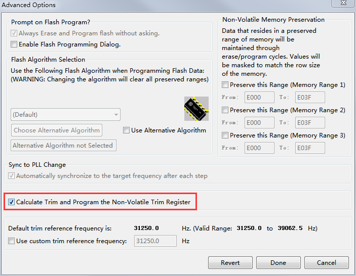

I want to work with the factory trimming values but, as far as i understand, those values are not loaded into the ICS trim registers if BDM is active.
This means that during development, while i am working with a debugger, i can not get the device to run with the factory trim values.
Is there a way to read and load the factory trim values into the ICS trim registers?
I am working with CW10.6, MC9S08PA8, P&E Multilink debugger
Timor
1,717 Views
w_tension
CodeWarrior load the TRIM value by default when debug, and it's optional, you can turn off.
User should load by himself, example projects do this, too.
