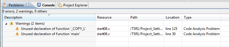

The start08.c code for the MC9S08 generates two warnings.
Unused declaration of function '_COPY_L'
and
Unused declaration of function 'main'
Since this is an analysis warning, the #pragmas don't work? There is a comment above the _COPY_L warning that says
/*lint -esym(752,_COPY_L)  inhibit message on function declared, but not used (it is used in HLI) */
How do I use this?

gregoryberardi
Thank you for responding.
and
Those are the exact warnings and as you can see there is no CNUM. How do I add the exception for this?

ZhangJennie
what's the warning message number? or can you please post a screenshot of it?

gregoryberardi
As you can see. There are no "warning message numbers".
Here is the offending code
__EXTERN_C extern void _COPY_L(void);
As you can see there is a comment that says that you can "inhibit message" but I don't know how to add this to lint in codewarrior.
This is the other offending code
/*lint -esym(752, main) main is used in HLI */
__EXTERN_C extern void main(void); /* prototype of main function */
Anyone know how to configure lint in codewarrior?
7,072 Views
ZhangJennie
i can't reproduce your prolem as your screenshot shows. can you please upload your demo project so that we check see the problem directly? thanks!

gregoryberardi
I started a new project and copied the code over to it and the problem disappeared. Thank you for your help.
