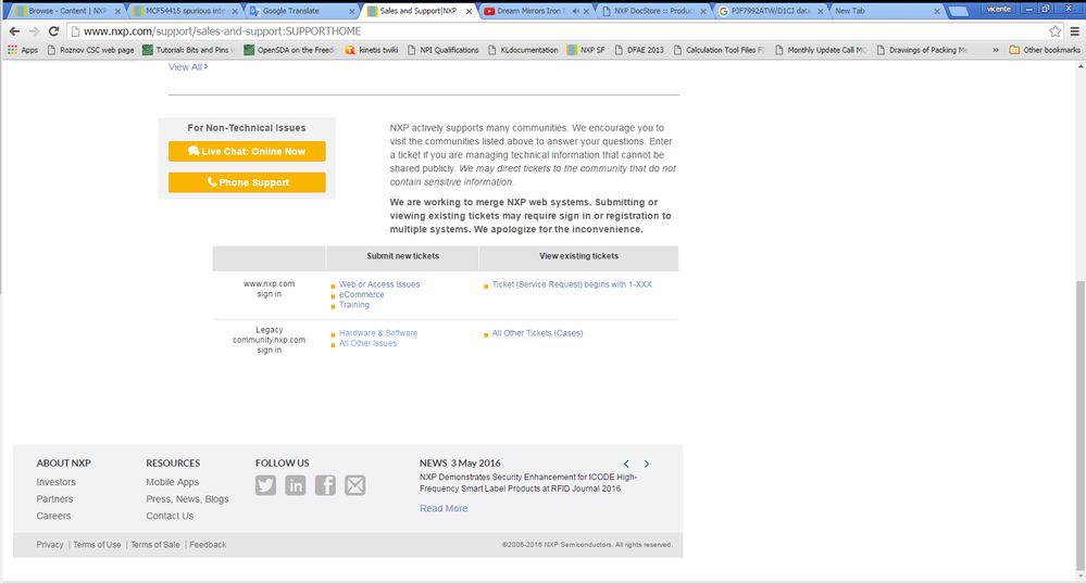

vicentegomez
Please please help me to create a new thread with the new problem
or if you have confidential information please help me to enter a case on the web page under support
And we will help you.
