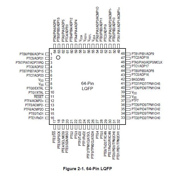

I meant clocking only TPM from external clock. See Fig 16-2. TPM Block diagram. TPM counter may be clocked from bus clock, from fixed system clock, or from external clock fed to TPMxCLK pin. So if you could apply externally gated external clock to TPMxCLK, this would function similar to gated pulse accumulator on HC11/S12.

pawankumar
Hi Edward,
I feel they refer to the Crystal Clock derived through EXTAL&XTAL pins in the image above.
Please correct me if I am wrong.
Pawan
6,906 Views
kef2
Senior Contributor V
Yes, you are wrong.
6,906 Views
pawankumar
So, which pin is it?
6,907 Views
kef2
TPMxCLK
6,906 Views
pawankumar
Oh... Okay Edward,
Thanks :smileyhappy:
Fortunately, the IIC module isn't used.
