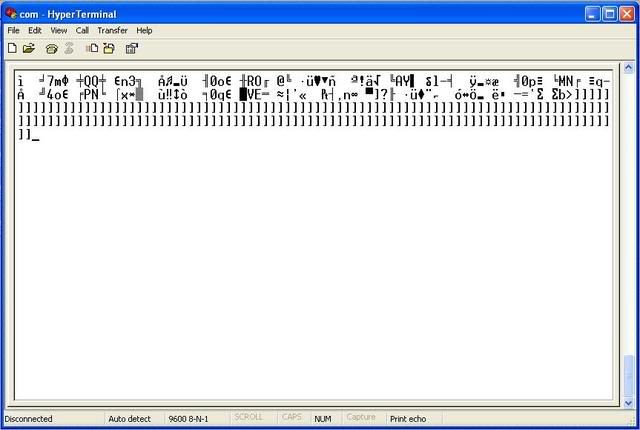

Hello all.  I'm trying to read an analog input ranging from 0 to 2.5 volts, convert it to a digital signal, and read the bits outputted through hyperterminal (for now...).  I will eventually be using a gui to take these bits and make sense of them but just want to get a solid reading first.  I am getting a reading but it is a bunch of letters and symbols on hyperterminal and I'm not sure why.  When I remove my input I get a bunch of "]"'s, so I know it's reading something from the ADC when it's hooked up.  Below is my code and a picture of my output.  Any ideas would be appreciated.  Please let me know if anything should be changed or is unessesary as I'm new to microcontrollers, Thanks!

My output:
Hyperterminal reading

You are sending a raw byte value to a device which is expecting an ASCII value.
The byte valuereturned from the ADC varies between 0 and 255 decimal or 0 to FF in Hexadecimal.  To display the numeral "0" to "9" on hyperterminal you must send the hexadecimal values 30 to 39.
There are lots of ASCII tables on the internet if just google the acronym ASCII or just go to www.asciitable.com
You will probably need to write a conversion routine or use one of the stream formating functions like sprintf to format your data before sending it to the serial port to Hyperterminal.

The use of sprintf() to do what you require is somewhat over-kill.  Here is a much more compact function to do the binary to ASCII conversion.  It uses inline assembly code for fast operation. The numeric ASCII characters are written to the buffer, and null termination also occurs.
void conv_ASCII( byte val, byte *buf)
   __asm {
      LDA   val
      CLRH
      LDX   #10      // Divisor
      DIV
      PSHH           // LS digit
      CLRH
      DIV
      PSHH           // 2nd digit
      LDHX  buf
      ADD   #'0'     // Convert to ASCII digit
      STA   ,X       // MS digit
      PULA
      STA   1,X
      PULA
      STA   2,X      // LS digit
      CLR   3,X      // Null termination
The function might be used in the following manner -
byte buffer[4];
ADCSC1 = 0;                    // Commence new conversion Ch0
while (ADCSC1_COCO == 0){}     // Wait until conversion complete
conv_ASCII( ADCRL, buffer);
while (*buffer) {              // Check for null character
   while (SCI1S1_TDRE == 0){}; // Wait for transmit buffer empty
   SCID = *buffer++;           // Write character to SCI
SCID = ' ';                    // Separator space
Mac

berb_15
Mac, I tried to implement your code but I'm throwing an error. I think it's probably something small or dumb but unfortunately I'm not fluent in coding...
At this line it says: Wrong type or not an lvalue
I used byte buffer[4]; at the beginning of my code to declare it but somethings still not right... Should the array be a different size??

RichTestardi
Senior Contributor II
You might try "SCI1D", assuming you are using UART 1.
Or did you forget the ";" on the preceding line, or forget to include "MC9S08QE128.h"?
If you get really stuck, you can usually right-click on a .c file and select "Preprocess" to see exactly what the compiler is complaining about.

RichTestardi
Oh, and *I'm* sorry -- I read your code too fast...
You can't do a "++" on a variable declared like:
byte buffer[4];
Change that to a "byte *buffer;" and make sure it points to allocated memory.

bigmac
Specialist III
Sorry about the misleading information.  Rich T is absolutely correct on both counts.  The following revised code should compile.
byte buffer[4], *p;
p = buffer;
while (*p) {                   // Check for null character
   SCI1D = *
p++;               // Write character to SCI
SCI1D = ' ';                   // Separator space
Mac
7,543 Views
berb_15
Ahh ok that works for me now.  Thanks a lot for the help!!
