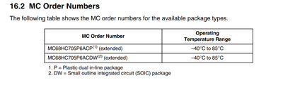

When I search MC705P6ACD, MC705P6ACDWE jumps out, so I am wondering what's the meaning of suffix "WE"
2,223 Views
vicentegomez
the DW is SOIC package and the E is lead free part
I hope this will help you.
