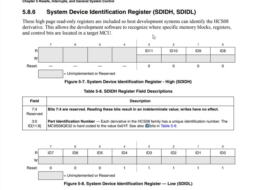

Hi, everyone! Is there a unique device ID in MC9S08? I failed to find a ID in the manual。

vicentegomez
Do you have a specific part number, for instance, the QE family has this ID
I hope this will help you
6,214 Views
sam_lgu
SDIDH SDIDL should be no difference in the same series device.
i want to realize firmware protection with unique device id, so it has to be different and readonly among chips.
6,214 Views
vicentegomez
sorry, in this case, no the s08 does not have it
6,214 Views
tonyp
Senior Contributor II
I suspect he may be looking for UUID found in newer S08 MCUs, such as the PA variant.
6,214 Views
vicentegomez
Yes you are right, I was forgotten of the P family
